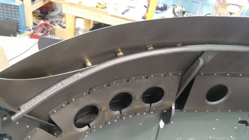

I'm building an RV-7 with tip-up canopy and have an issue with the WD-716 1/2" tube and the C-702 canopy skin. On each side of the canopy, the outboard 3 or 4 rivet hole locations on the WD-716 tube have a significant gap between the tube and the C-702 skin. Van's says this is "normal" and suggest filling the gap with washers before riveting. However, a couple of the locations have a gap as large as 3/8", and that is a LOT of washers. Just wonder what some of you other builders have done. Thanks.

http://www.vansairforce.com/communit...ad.php?t=16356
http://www.vansairforce.com/communit...ad.php?t=96142

I used washers then ended up filling in the gap with epoxy so they are hidden. The canopy on these models suck! For such a nicely engineered aircrtaft it's a shame to have this canopy that seems like an intern designed.

I placed a piece of clear packing tape as a backstop behind the gap. Mixed up flox/epoxy with pigment and made a nice filet. No spacers or washers.

I cut some small tubing segments, filled them with aluminum epoxy putty and so far they have been pretty solid (750+ hours). You could probably use something like JB Weld to hold these in place and fill them.

I think I just had the last one or two that I just couldn't make work out with any amount of massaging. I didn't even mess with trying to "fill" the gap. I just put a rivet in the empty holes in the top glair shield and moved on. It has looked fine to me for all these years.

I had three rivets on each side to nowhere.
The I stuffed it with flox:
