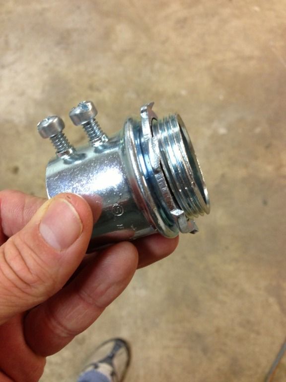

Originally Posted by crabandy View Post
I bet it was one of these, I saw them in the conduit section and for $1.50 I bought a couple of sizes to possibly use.
These are probably not a good choice with the sharp edges. In the same department you can find chase nipples which are made to not chafe the wires. They are threaded for locknuts also.
