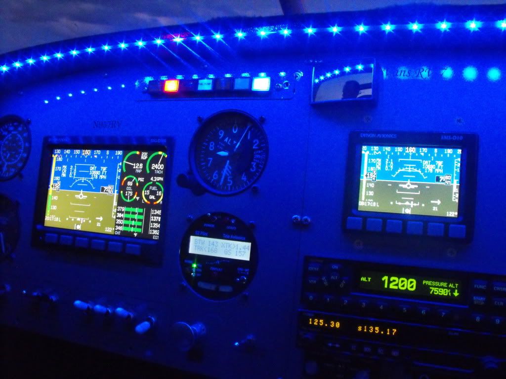

I have a slider -7, and fly almost weekly with my buddy who flys a tip-up -6. He won't fly if there's any weather, because of the water that drips down onto his avionics through the tip-up joint.
I have a three part panel, divided between the Flight Instruments, the Radio Stack, and the Passenger Glove Box panels. By just removing a couple of screws, I can remove an entire panel for maintenance. Although I still spend a lot of time inverted under the panel, it's only because I'm still limber enough to get down there without too much damage to my body.
In the photo, you can see the joint between the Flight Instrument Panel and the Radio Stack Panel...

cool photo!

Nice job Scott, I've got the same panel setup, works Great!

Scott with a surname like yours and a panel like that I surprised that you haven't been nick names Disco Stew
(Ref: the Simpsons)
