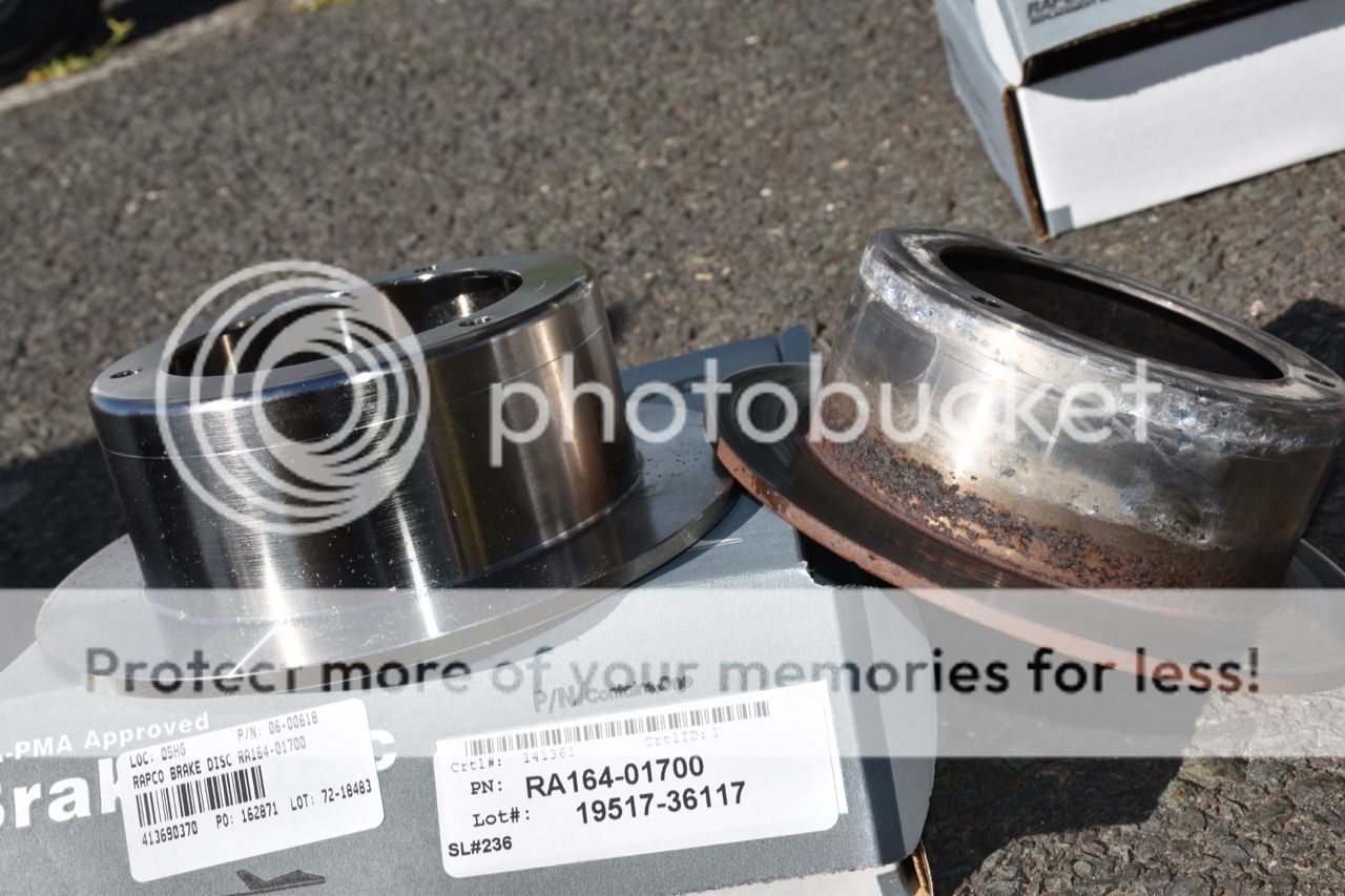

I just finished up my 5th annual condition inspection and my extra project this year was to do a brake upgrade.
Write up and photos are on my blog.
Basic story is for about $300 you can install thicker brake discs on your OEM Matco calipers and wheels and get much better braking capacity. I've seen other threads on VAF that discuss this type of an upgrade, but it involved making spacers and trimming down the wheel nuts to make it fit. I found a nice way to make it work without all of that.

Nice write-up Bruce. Are the rotors and spacers in production? I can't find the part numbers on your site listed on Matco's site.
Qty 2 – WHLD164-017HE – ROTOR, BRAKE DISC HIGH ENERGY
Qty 2 – WHLBSPE5L – SPACER, Long CALIPER E-SERIES
Qty 4 – MSCAN4-22A – BOLT
Thanks,
Greg

You need to call Matco. They don’t have these parts listed on the web site.

Originally Posted by GilbertRV View Post
....I can't find the part numbers on your site listed on Matco's site.
Thanks,
Greg
I called them and the young lady that I spoke with said that those were valued part numbers and that they do in fact have those parts in stock. They were about to close so I wasn’t able to talk to the main guy that could confirm if those are in fact the correct and only parts that’s needed for the upgrade. I’m going to call them back tomorrow to to confirm everything is correct and place my order.

I pulled the part numbers off my invoice so they should be valid!
