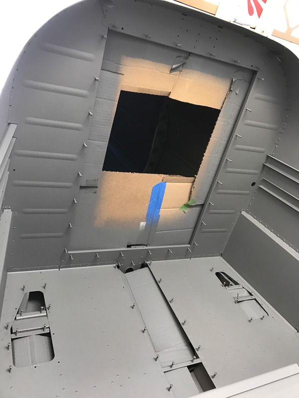

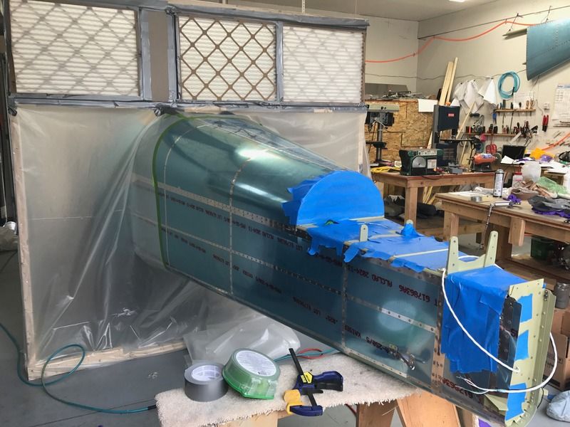

So I ended up with $30 of material from HD and made a plastic box in my shop to paint in; typical with a filter on one side, and a filter/box fan blowing out the barn door. they have this awesome plastic film 4x10' that easily stretches out over the fuselage and the static makes it stick while you get ready to tape it down. Masked off everything but the forward cabin and shot the paint.
I did brush the little pieces on the firewall for the heater flaps and for the bracket I made for the parking brake. Its okay for little things but would look just awful if I had painted the interior that way.

Apparently I am still at the same point as you are. It just got warm enough to paint. Well I was told that it needed to be at least 50 F to paint. Here is a picture of the "paint booth". I pushed the paint up to the back of a smaller paint booth and then built a bigger temporary booth around most of the plane.

Might have to spray one more coat.

I plan to assemble the roller next, paint all the pieces, and then put in place. I will post more pictures when I get it done.

Hey guys, this plus the fiberglass fairing work are the two most concerning steps to the build process for me.
What brand/type paint are you using and how are you applying it? Also, is that just battleship gray?
Do you have any additional pics?
