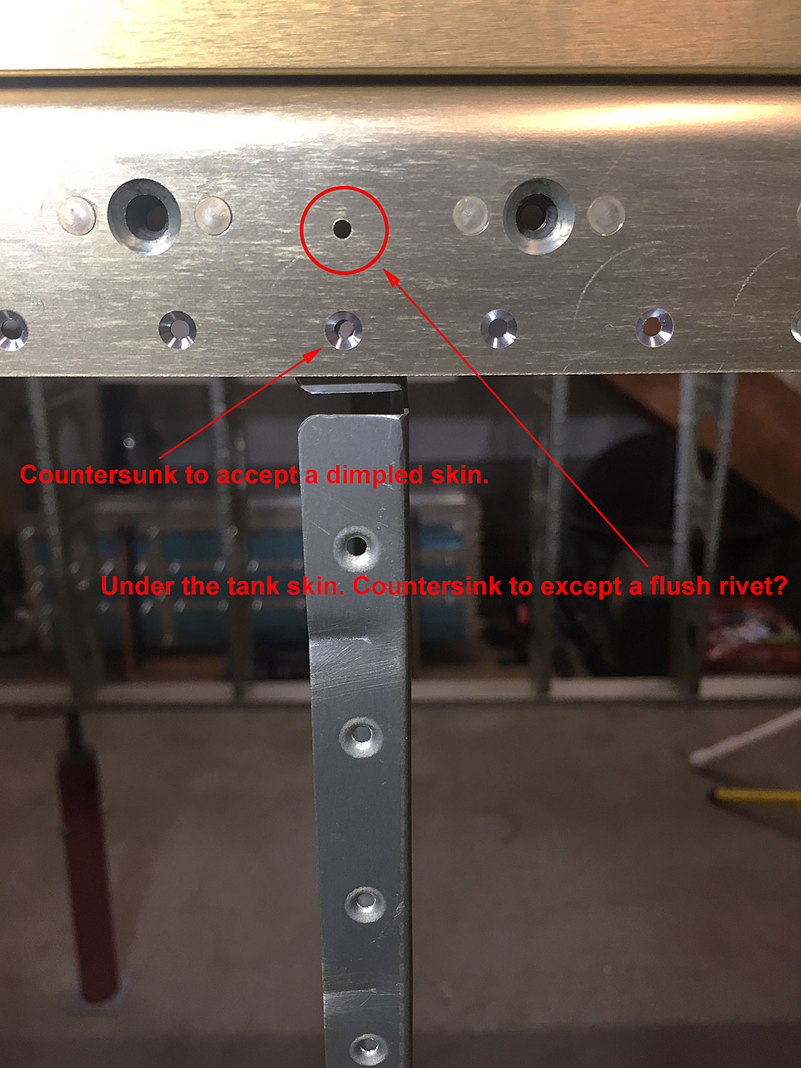

I'm in the process of countersinking the main spar skin rivet holes on the spar web on a RV-7. The countersink depth is set so a dimpled skin will fit.
In the fuel tank area, there are two rivet holes at each main rib location. This is the same as the leading edge area, except the leading edge area has two rivet holes at every location (one for the bottom skin and one for the top skin).
I can't find a call out for the top rivet hole in the tank area. It seems to me that the rivet hole must be countersunk for a AN426AD3-XX rivet.
Van's couldn't say for sure and will be getting back with me on Monday.
What does the collective say?

I countersunk those . I did it after the tank was done, so had to take off the tank one more time to do these. See my blogspot or my forum posts of my build on here. (Search pilotjohns on here.) these were done to make the river flush. I would set those rivets before match drilling the skin.(i didnt)

Yes, countersink. (Rivet is for rib flange only)

Thanks for the help! Confirms what I suspected.

Michael, did Van's ever get back to you with a specific rivet length call-out for these? I'm curious too, and found no reference in the plans.

Boy, expecting me to remember what happened 3 months ago is asking a lot
Van's called back and no, they couldn't find the callout either
They agreed that countersinking was correct but we didn't discuss the rivet length.
I believe I used a 3-3.5.
