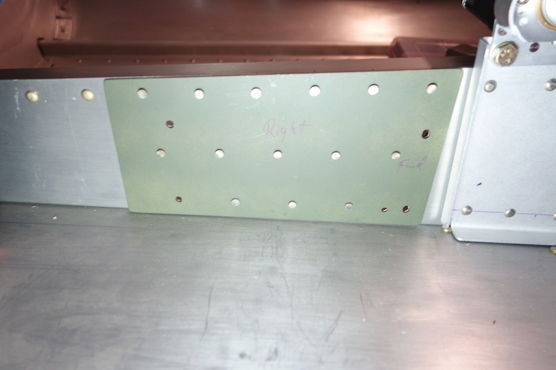

I see Van's has a mount kit for an ELT or Whelen power supply. Where exactly are they placing this mount? Does anyone have a set of instructions for this mount?

The mount gets riveted to side stringers. Vans has a plans page for it and it's on the Plans DVD.

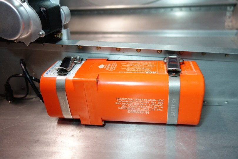

I've heard that ELTs mounted there don't stay put in crashes, so I mounted mine to the center fuse rib that the elevator autopilot servo gets mounted to.

For the ELT, I didn't bother with the Van's mount (though I used it for the Whelen power supply). I just made a gusset out of .063, riveting it to the top of a bottom rib and bulkhead on the pilot side just aft of the baggage wall and mounted an Artex 406 to that, which also provided a path for the antenna run up the center vertical post of the baggage wall to the antenna on the top (I kinda dig the look of external antenna, which most people don't).

Is that stiff enough that in turbulence the ELT won't bang into the skin and dent it?
Old 12-05-2015, 07:22 PM
grayforge's Avatar
grayforge grayforge is offline
Location: Kirkland, WA
Posts: 879
Certainly. I have an .062 doubler on the other side:
