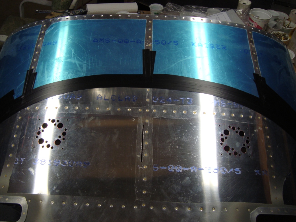

An option is to not use a grill at all, just drill an interesting pattern of holes in the glare shield instead of one big square hole. This strengthens the area so no backer plate is needed, and eliminates the ugly grill.
Sorry, didn't set up for photos but is anyone wants them PM me your email address.
+1. This is what I did. No flex in the glare shield. (In the -10 this is best done prior to installing the windscreen, depending on the exact location of the fan).
+2. Drilled some holes for airflow.

Carl's fan install
