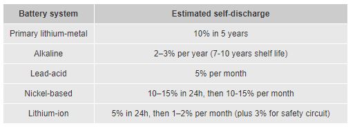

This may have something to do with it.
https://batteryuniversity.com/learn/...self_discharge
That discharge rate is for flooded lead acid. Sealed Lead acid, like the Odyssey is much lower. Forget the exact number, but I thought it was in the range of 2% per month.

Just as a data point, EarthX is a LifePO4 (not on that chart).
LiFePO4 is also very resistant to self-discharge. Remember the old days when your NiCad batteries would go dead in a month or so just sitting on the shelf? That’s because they self discharge at rate of about 1% per day. LiFePO4 has a typical self discharge rate of 5% per month. In other words, it takes six months for a LiFePO4 battery to self discharge to the same level a conventional battery reaches in just thirty days.
