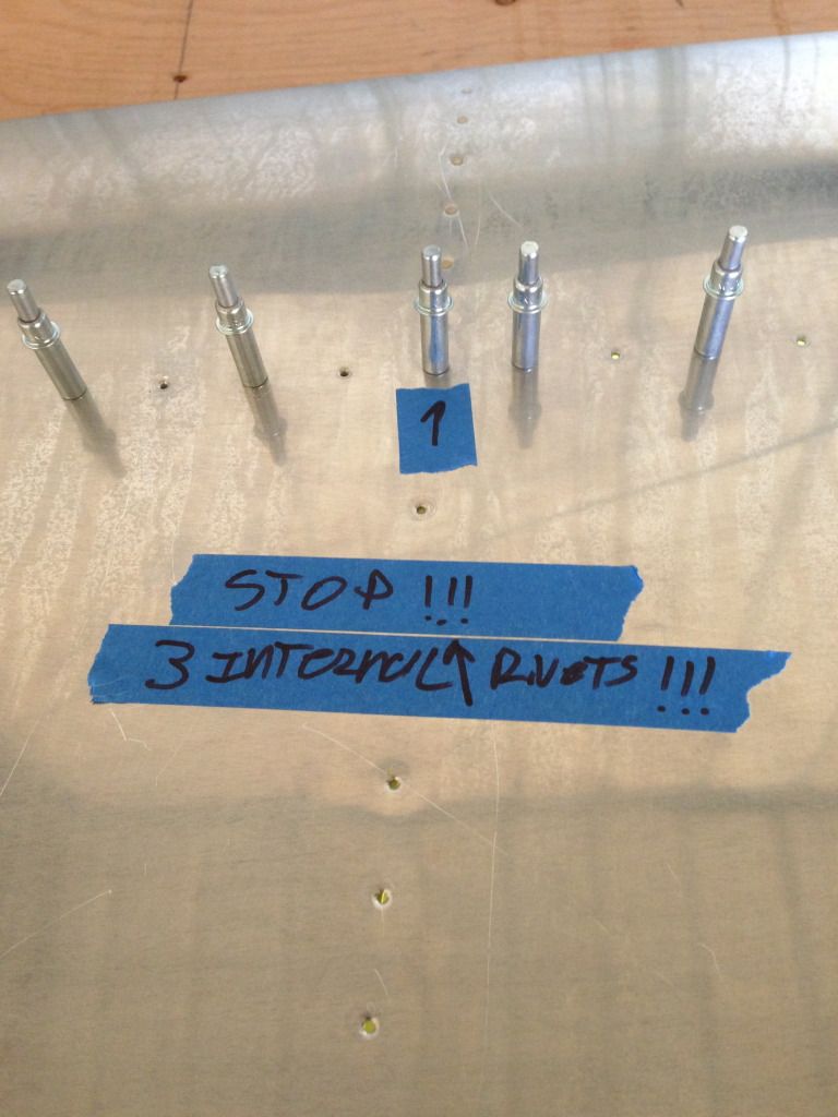

I got the nose rib top and bottom riveted and stopped there. I want another set of eyes to come by and take a look before I close the skin up so a friend of mine who is an A&P IA is going to drop by and look over the work to date. Since I stopped mid stream I left myself a note so I wouldn't forget the 3 bind rivets for the HS 702/707/708.
