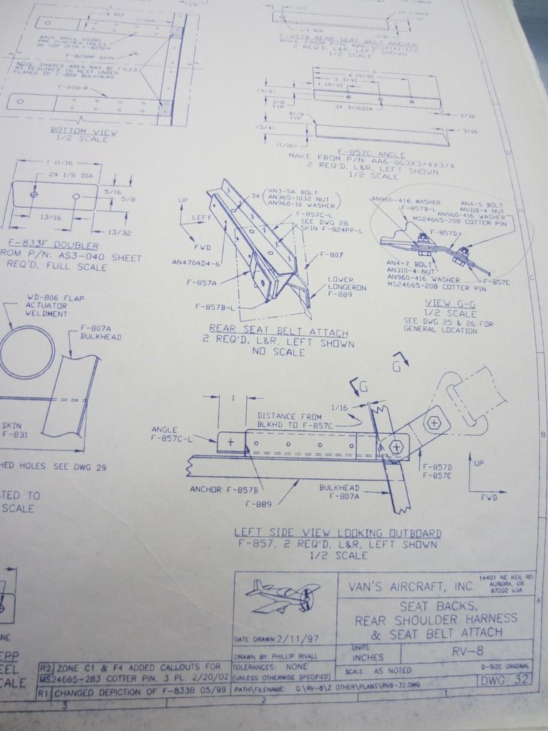

I'll be making the bushings and spreading the attach points to accept the 3/16" thick Crow brackets. Could not find any mention of the F-857D&E offset bars on VAF that the plans for the 8 say to use to attach the rear seat belts. The offset bars look like they were designed to have the seat belt attach clear the arms of the flap actuator.
It looks likes you could get away without using the F-857s and simply bolt the Crow brackets in directly.
What have others done with rear seat attach of Crows in an 8?

Your rear lap belt attach is different than mine. Mine is a 2002 vintage (see attached DWG32). Yes - I am slow building. The F-857D&E are separate bars that pivot bolt to the airframe attach F-857A&B . The seat belt brackets then pivot bolt to the F-857D&E.
I was thinking of eliminating the F-857D&E and pivot bolting the Crow seat belt brackets directly to the air frame F-857A&B.

Vans said they haven't tried attaching the seat belt brackets direct without the F-857D&E extensions but saw no reason not to give it a try - so I will. Thanks for the reply Andy.

Tried attaching the Crow brackets direct on my 8 but there was to much chance of interference with the flap weldment arms so I made up new & longer F-857D&E offset bars to take the thicker Crow brackets and opened up the aft side panel slots a little - not a big deal. This also keeps the Crow brackets and all of the belt out in the open.
