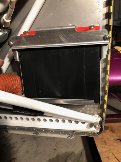

Yes, right where Carl's pic shows. I would not want to add any more weight in the tail than needed. The airframe comes out a little aft heavy by design it seems. I even thought of moving my ELT further forward but realized that was a dumb idea. I have 2 LiPo's (Earth X) on the firewall and seems to be a good combination. My prop is composite and of course that does not help but prelim W&B look ok.

Old 12-06-2019, 05:03 AM
dmattmul dmattmul is offline
Join Date: Dec 2015
Location: Spring Hill, FL
Posts: 84
Default Pic of location of second battery (I hope, new to photo sharing))
RV-14A QB building, Lycoming 390 Thunderbolt arrived July 2019, Garmin avionics, Vertical Power, EFII-32 Ignition and Fuel, Whirlwind 300-72, hope to be flying Summer of 2020 !! Dues paid+ of course !!
