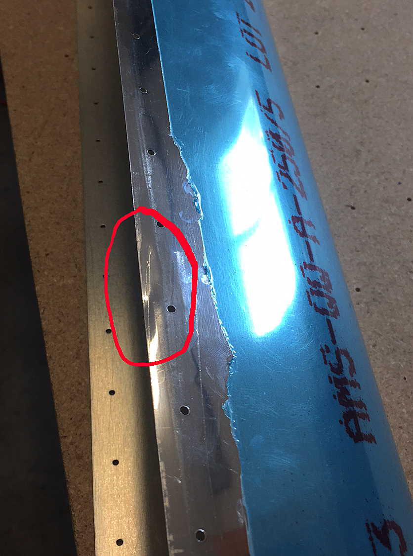

So I've creased the edge of my RV-7 aileron skin using the Cleveland edge rolling tool.
In an effort to prevent the tool from rolling off the edge, I obviously was putting too much force on the tool and it rode up up onto the skin putting a crease in its path.
Any suggestions if this is fixable?
Heres a photo:

Gently tap this out flat with a small ball peen hammer on an anvil.

With the emphasis on gently.
If you have a set of seaming pliers or a set of parallel jaw pliers you could try those too.

Tap it out on a wood block with a wood block and hammer so you won't stretch the aluminum.
You can press out a crease with a table spoon and a little lube.

I have done this exact same thing. It's not too bad to fix. I used seaming pliers to bend it back to shape by inserting the bend into the side of the pliers and giving it a good solid squeeze. Resist the urge to use the pliers as a bending brake as you could make it worse.
My pliers didn't get the bend 100% straight but it got it really close, so I used a very small hammer and gentle taps against a wood block to straighten it out to normal.
Then, go back and roll / break your edges again.

Yes, gently... When I slipped with the edge break, I immediately tried re-rolling the tool over the offending area and made it worse. I should have stopped and evaluated the part and proceeded GENTLY
That sounds like a good plan!
The edge break tool was trying to roll off the aluminum and I was compensating so hard on preventing that, I really made a mess
In hindsight, I will start with less pressure on the rollers and make multiple passes.

When using the vice grip edge breaker, you are not looking for any real pressure. You should be able to do your break with one pass. Set the rollers so that they are the thickness of the material apart. Just put the parallel part of the rollers over the edge,then adjust so they roll easily. Then lock them off. Open and get them to the full depth, then close them. I found the best result was obtained by holding them in position, then using my other hand to roll the rollers slowly along the edge. You really do only need one pass to get the (very slight) edge break you are looking for. They are not a force forming roller, just a couple of shaped wheels that impart a nice shape to the edge. I had similar difficulties at first attempt, but once I worked them out, I swear by them, not at them.
Hope you can make sense of my long winded description. Good luck
