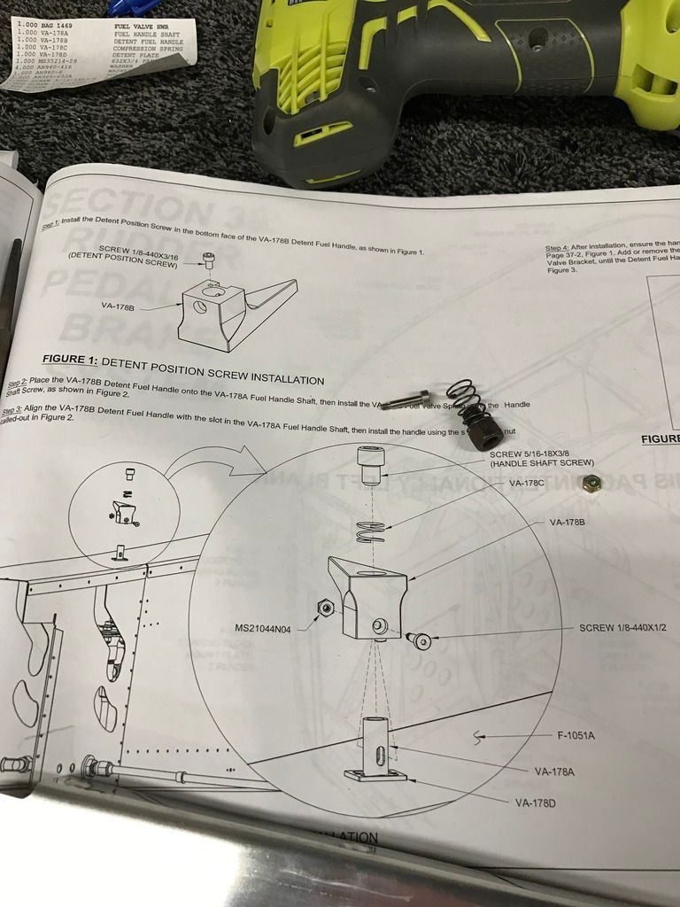

To all of those that have used the newer vans fuel handle (VA-178B), how did you get the handle onto the fuel handle shaft (VA-178A)? I would have to sand down the shaft to get it to fit.

I don't recall any issues getting the handle to fit on the shaft. Try going around the end of the shaft that goes into the handle with a scotchbrite pad and see if that removes the interference.

I decided to use sandpaper and make it fit. It moves in/out easily now but the handle does not lift easily. If I look into the center of the handle shaft, the screw is not centered in the shaft (it's offset).
I think I have a bad handle. The hole where the screw goes into it is off about 1/32s. So the alignment with the shaft is off.
Anyone else notice this on their kit? Should be a simple assembly but isn't working out that way

Take a picture of the installed handle and send it to the factory. They will verify the quality of the part and act accordingly, I bet.

Figuring the handle isn't drilled right, I used a #30 reamer and drilled the handle so it would work as advertised. Now the selector moves up/down easier. Put it together on the cover, to see how it would work with the set screw.
Honestly, not that impressed. It still doesn't move down into the proper location and feel secure.
May just buy the Andair one and be done with it.

The lower hole on mine was off, but rotating it 180 degrees fixed that. I haven't gotten the handle on the shaft yet, but when I was playing with it, it wouldn't just push on so I figured I'd need to ream the hole a bit and sand the shaft.

Hmmm. I wonder if there has been a batch made with some quality problems as mine didn't have the issues noted above (and I have the stock plumbing setup), but is probably 4 years old or so.
