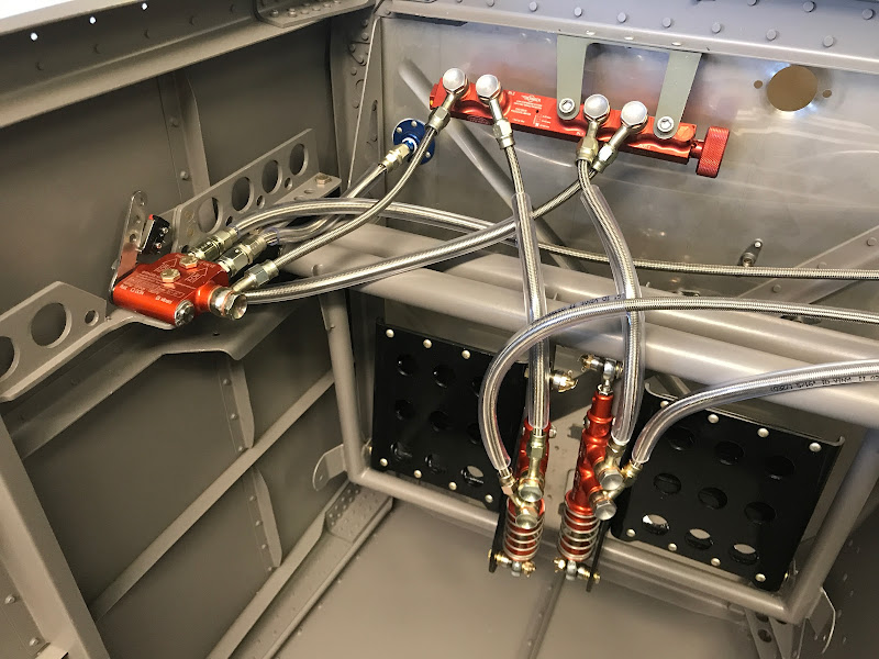

Here's my Beringer install. I found that 5/16" ID vinyl tubing works great for protection from rubbing. I decided to install the parking brake on a modified piece of 1.5" L-bracket with a microswitch to hook up to the efis. I will trim the excess vinyl tubing once I can see where the rubbing happens.
