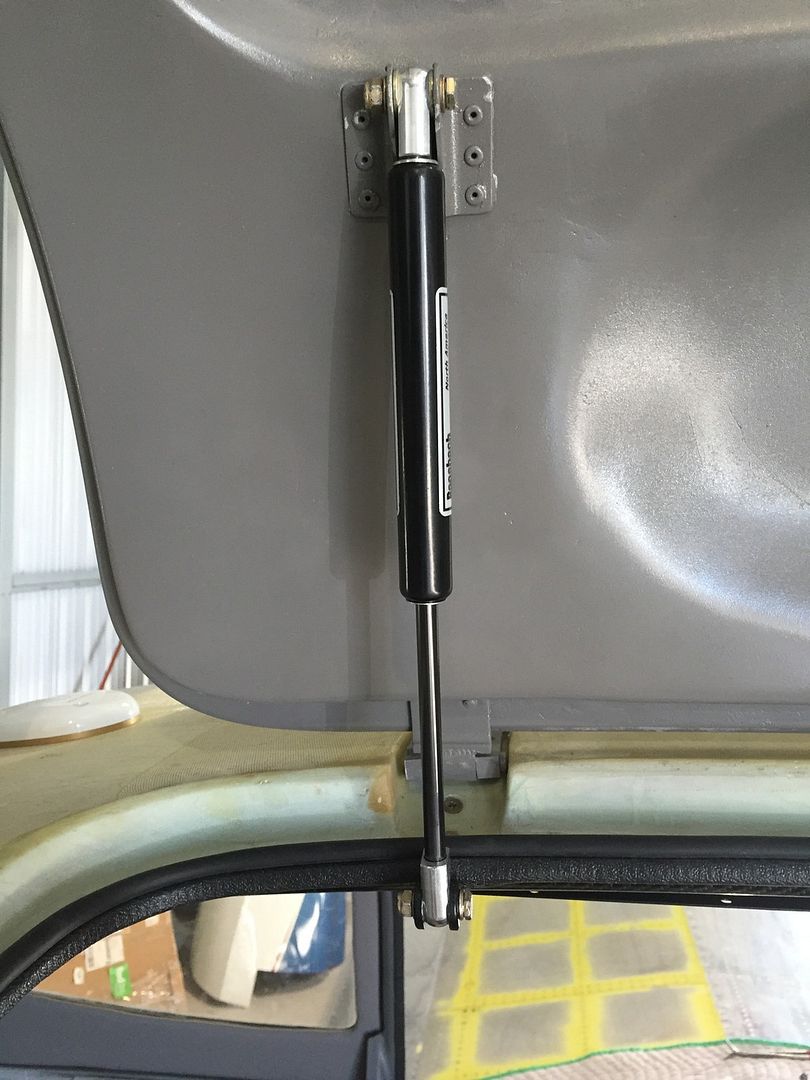

Default Heres what you need to order
Mine died before we even got flying...
Called Bansbach, and gave them the part numbers others had referenced... They have a new ordering system and new part numbers... basically, you order the strut in the length and force (Newtons) that you want, then order the appropriate ends...
A1 M8 Hinge Eye Endfitting
96102 4 $3.49 USD $13.96 USD
B0N0F50-100-247/XXXN Gas Spring 4"(100mm) Stroke 10"(247mm) Extended Length Customer Selected Force
(Forces Available: Custom force, Custom Force: 600, Custom force in pounds or Newtons? Newtons (N))
TOTAL For BOTH DOORS was $73.50 with Free shipping... Great deal!!! They are perfect and work great. If you have the Plane Around Bracket, you'll need to grind the end down a bit to fit.....
