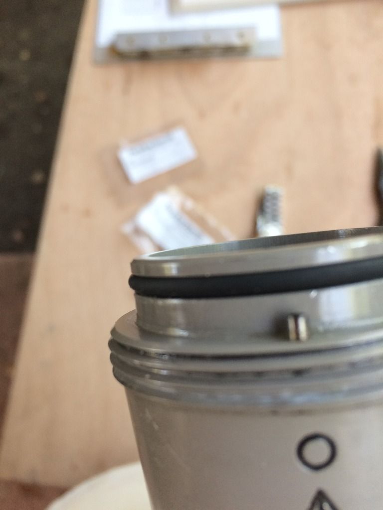

Today I opend one gascolator and cleaned the filter, put a new o-ring on and installed it again.
It was no problem at all! Also the old o-ring did not look'd bad/bigger!?
Old one:
New one:
Its difficult or nearly impossible to measure the o-ring size, because of the big diameter, you need a cylinder with the exact dimension to try and find out.
Toolshop is far away, so no quick trial.
I wonder if your o-ring that you purchased came like this or if your vendor buy them by himself someware else?
I made a video where I install the bowl ... buy my iphone dont want to share it ... give me time to find out. https://goo.gl/photos/tV9XNosfGaXG5mJD7
I also was whiping around the seat of the o-ring on the cascolator-housing, with the finger that I was putting a small amount of fuel lube. Not a visible amount, just to not have it dry there.
