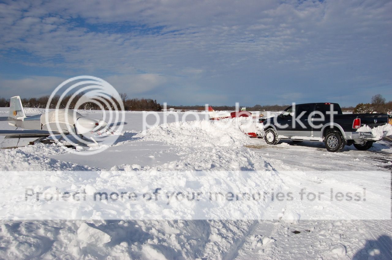

Good question Michael. I am parked in the open and I fly all year around. Preheating the engine and the battery is the only option. If you have access to electricity it's very easy. I use a propane heater. Once I was stuck in the cold for two days not in the boonies by a civilization but without my propane preheater. Before start I put a water warmer over the battery then quickly poured two quarts of hot oil (probably was around 180F or so). Started but you don't want to hear the clacket and whine of cold engine parts. It's not only awful sound it's damaging for the motor too. Preheat good. Always.
