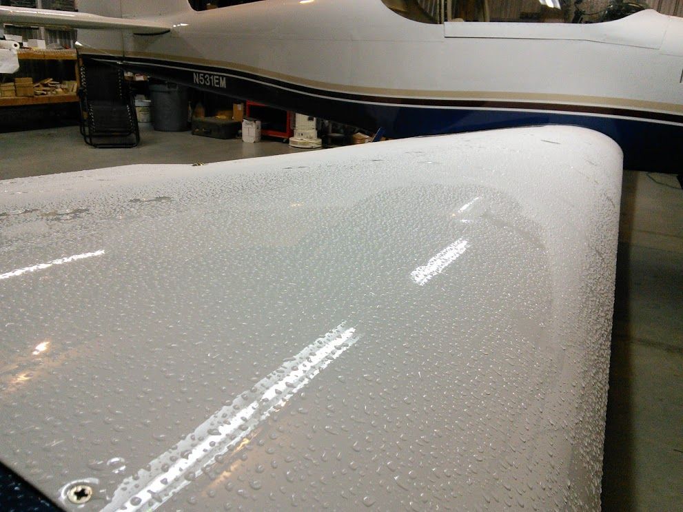

For those thinking about what brand of paint to use on their RV, Iíll give you a data point to consider.
The pictures below show my exterior paint after todayís flight through rain. Paint is 12 years old:
- water still beads
- never been waxed
- always hangared except for 10 Oshkosh visits and a few other trips.
Paint is Sherwin Williams AcryGlo. Yes, I have the usual hangar rash and paint does get thinner with age, but overall still looks good and garners compliments. Iíve been pleased with it. Hopes this helps.
