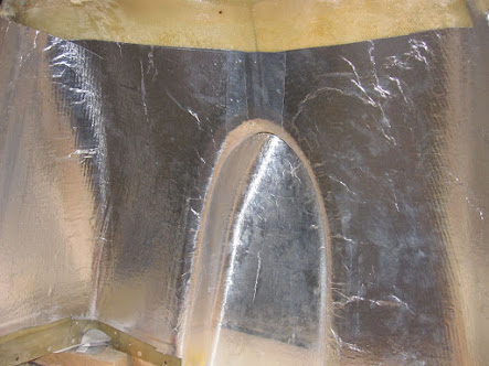

Add a heat barrier to the inside of the bottom cowl:
Bill R.

Nice work, Bill. Does that foil come adhesive-backed? If not, what glue do you use?

Fiberfrax and heavy-duty foil bonded with RTV makes an excellent cowl insulator. Keep the Fiberfrax about 1" inside the foil border to ensure a good seal.
Right on...a reflector over an insulator.
Fiberfrax felt works well under the Vans self-stick reflective aluminum foil.
