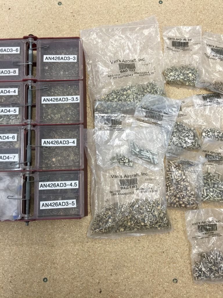

I have quite an assortment that came with the partially-completed kit, including some that were probably in the builder's shop from even older projects. Most that are part of my kit are still bagged from Van's, in 2010-2011. I've heard about age-hardening of rivets and don't want problems with cracked heads when it comes time to shoot these.
Any way to tell ahead of time what the likelihood of issues is? Is there a rejuvenation trick for ancient rivets, if I have any?

a search of the archives answers nearly all questions (we are almost never the first to have a dilemma, are we?)
I learned that the rivets are likely a-okay, and a little cracking when driving is within mil-spec, even if they are age-hardened somewhat. I'll shoot-n-see, and replace inventory if necessary.

Let Mr. Google help you------- try searching for "annealing aluminum rivets"
Here is one old thread.......
http://www.vansairforce.com/communit...ad.php?t=50763
A buddy who is an old time RV guy actually has a small table top oven/kiln to anneal or soften rivets.

The rivets used on the RV (AD rivets with single dimple in head) will not do anything to change hardness over time. As long as they are kept dry, you can use them forever and ever..no worries. If they were D or DD designation(single bump or double dash on head) that were shipped in an "ice box" condition and stored on dry ice, they would remain annealed for a period of time for shooting purpose. I work with these all day, every day, and have the means to "cook" them (D/DD) rivets into an annealed state if need. Keep them on a shelf in case you want to build or repair something down the road.

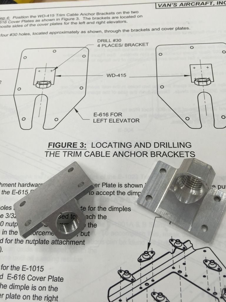

Plans call for WD-415, by designation and depiction in the plans - a welded steel part. Lots of the bits in my kit are unbagged and scattered as I received it from previous owner. Am I correct in assuming these milled billet aluminum pieces are what I seek?

Yes, that is correct. Dimple the plate, countersink the billet part.
I would suggest that you use screws and nuts to hold the parts instead of riveting them----------much easier to install the parts separately compared to a riveted together assembly.
