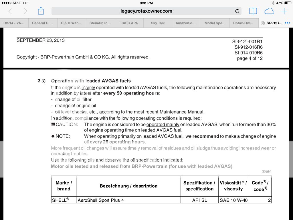

If you use 100LL you can't purge the lead out. You can remove the tank and clean the bottom out and drain the oil, but that's it.
The Rotax SI912-016R6 says 50 hrs at the latest, but still recommends 25 hr. changes when using mainly 100LL. Sec. 3.3. The 25 hr. change is under notes.
After doing a pre-buy inspection today on a Remos with 700 hrs. that already had a top end done on Cyl. #2 and seeing all the lead on the tops of all pistons and in the oil tank I would stick to 25 hr. changes and make sure I use a fuel additive like Decalin as a lead scavenger. It isn't a cure all, but does help. For me tossing in a couple extra oil changes is way cheaper than paying the big bucks to send in heads to have lead removed and the gearbox has to go in at 600 hrs. verse 1000 hrs. to get the lead out of the clutch. If you can stay away from 100LL and use 91 oct. you will be far better off with future maint. and your pocketbook will thank you.

Big John I trump you with page 4 September 2013
