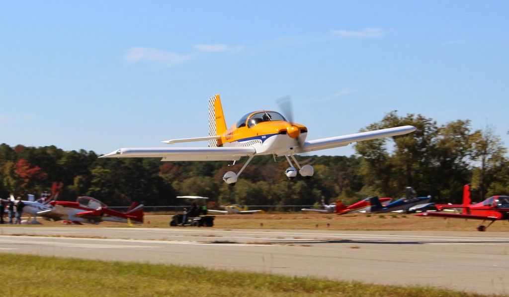

I painted both my planes yellow and white and had a sign shop do the black and blue colors. If you ever painted checks you know how much easier it is to have the sign shop do the rudder in vinyl.
The 9 good for 11 years so far with new owner. The 12 working on 3rd year. I make sure the stripes are wide enough to cover up the lines separating the white and yellow with a little bock sanding along line to cut down on the ridge. Even so it does clearly show through the vinyl. The new vinyl is much better without bubble problems.
