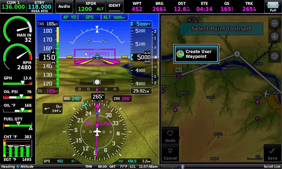

Hi Ed,
This function was actually added in G3X Touch v2.80. The feature is formally known as graphical flight plan editing. Simply press the MENU button when your on the FPL page. Couple screenshots below for reference.

Awesome! I'm excited to get these screens installed and powered up in the next month or so!
