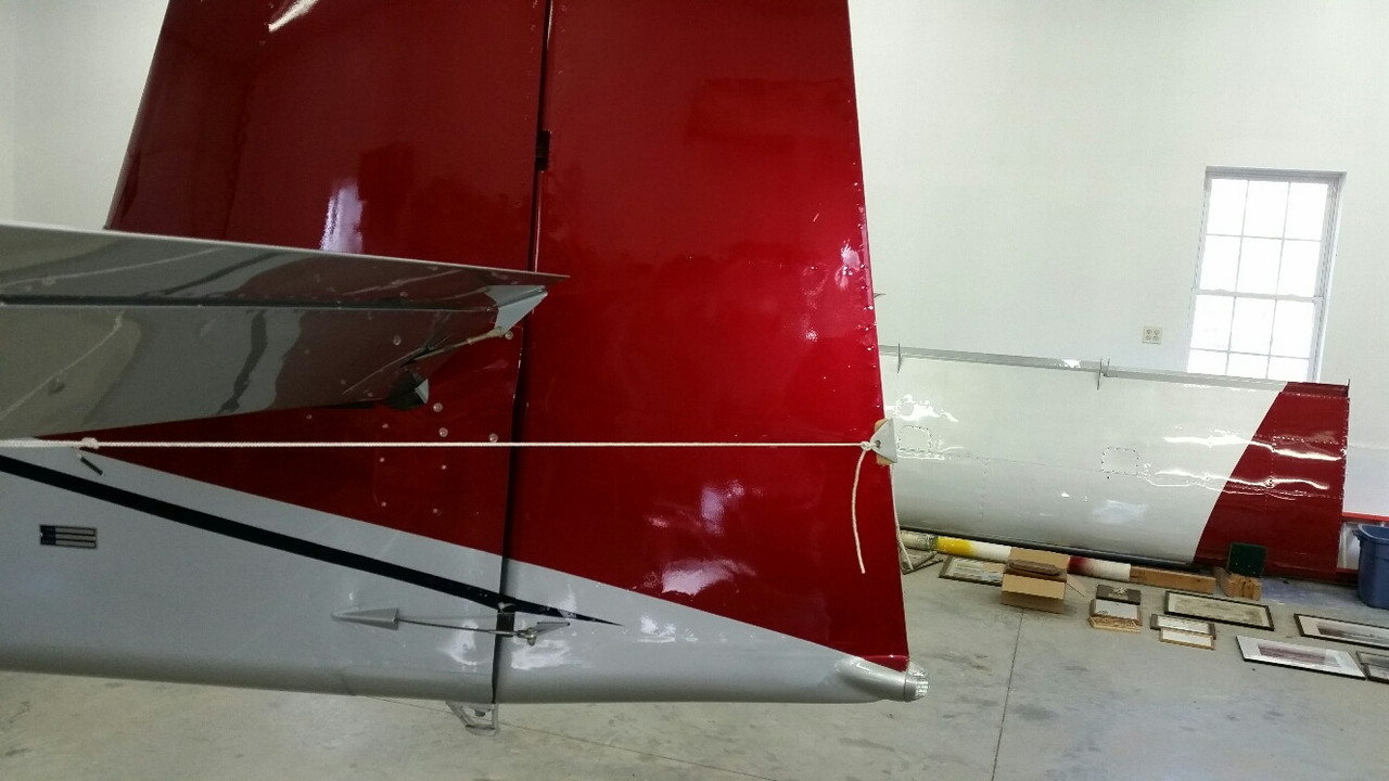

Default Rudder lock
A piece of aluminum angle, some foam padding and some white line.
The line goes through the elevator leading edge cutout for the journal bearings, back down and tied with a Bowline knot. The elevators and ailerons get secured with the pilot seat belt around the stick.
This has keep the rudder locked and secured in all types of weather.
