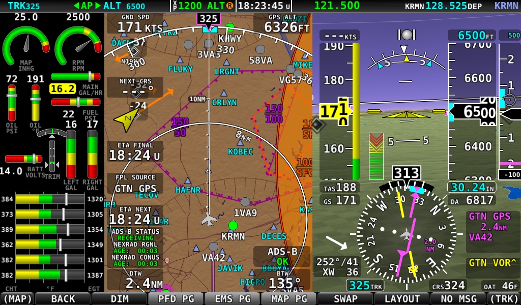

I built using the James Cowl, Plenum and Wheel Pants. This added time to the build but I'm happy with the performance (a couple of screen shots attached). The plane has a stock engine and prop from Van's.

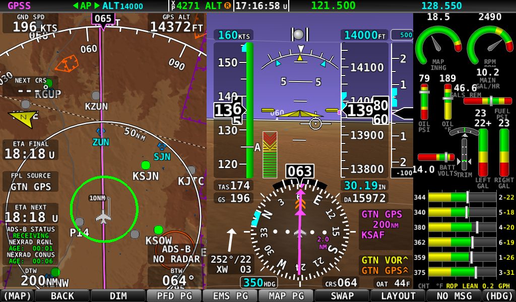

You are probably aware of this, but I'll mention it for others. The Dynon SkyView (as does other EFIS mfg's) allows the Vne (Redline) to be input as a TAS value (i.e., Vne = 200 KTS TAS for the RV-10).
At the flight conditions in your screen capture, Vne would be approximately 182 KTS IAS. The SkyView would show that Redline on the Airspeed Tape.
Below is a SkyView Touch screen capture from my RV-8 illustrating the effect. The RV-8 has the same Vne as the RV-10, but shown in MPH (230 MPH TAS). At the flight conditions in the screenshot, Vne = 197 MPH IAS.

Carl, that is way faster than Vans numbers, have you checked your TAS vs flying a GPS box to verify static error?
If the static is pretty close you have one slick machine!
