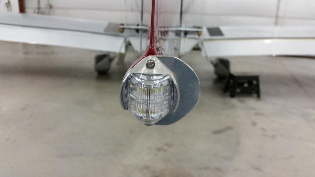

Cleveland tools sells the plastic trim wedge for 15 dollars. Itís paintable. I Installed it just above the lower rudder fairing on the trailing edge of the rudder. The plane was 1/2 ball out, now the ball right in the middle at cruise.

Originally Posted by Carl Froehlich View Post
Here is the simple trim tab I mentioned in my earlier post. Not my idea - I stole it. Hard to see, but the tab is bent aft perhaps 30 degrees.
That's brilliant. I'm definitely stealing this.
Iím confused by this set up. The tab is pronounced on the right side of the rudder, which in turn would cause a left rudder deflection as a result making most trim situations worse.
My Christen eagle and most aerobatic planes have a small
Tab on the left side of the rudder to offset the right rudder needed
To stay in trim. Am I missing something in this setup?
Depends on the plane, my ball was about 1/6th out to the left in cruise, needing just a dab of pressure on left rudder in cruise. Applied about 1Ē length of the Cleveland trim tab wedge to the right trailing edge of the rudder, problem solved.
All I can say is when I'm in straight and level cruise at 75% power I have to keep steady pressure on the left rudder pedal to keep the ball centered.
