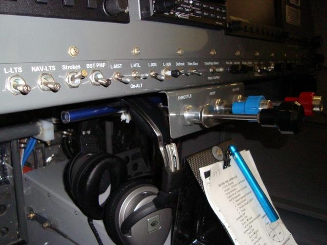

Other than the necessity of front seat shoulder belt hangers, I never liked stuff hanging from the overhead.
This is what I did. Simple, cheap, and does the job. This thin wall aluminum tubing extends a few inches on either side of the engine control bracket to hold the pilot and co-pilot headsets. There is no issue with hitting them when getting in or out of the plane. The short piece of vinyl tubing was added just to keep the edge of the aluminum from hitting the headset padding.
