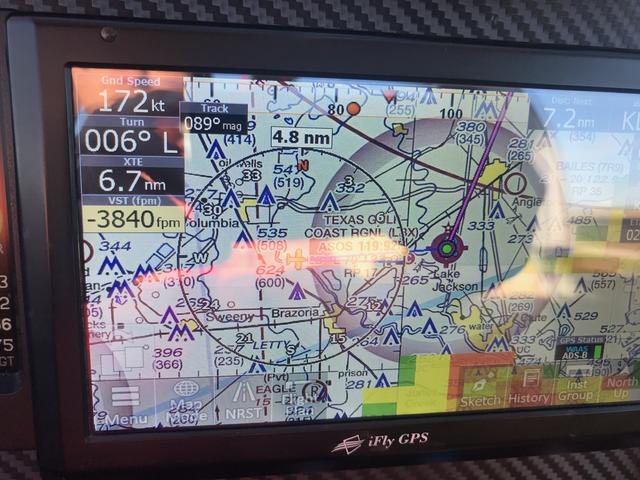

Originally Posted by DaleB View Post
Interesting. I've seen NEXRAD in Avare, it looks pretty reasonable. I've also seen it (via SiriusXM) on the 496; it looked like a very early 8-bit video game gone wrong. Good enough, really, given that I'm VFR-only and generally try to stay as far away from all but light precip anyway. If you've seen what I'm talking about, is it about like that?
This is wx radar from this morning displayed on the 740 via stratux wifi.

Yeah. About what I saw on the Garmin when it had XM WX.
Pretty impressive dive, by the way.
Nice looking install. How about a panel pic showing it?
