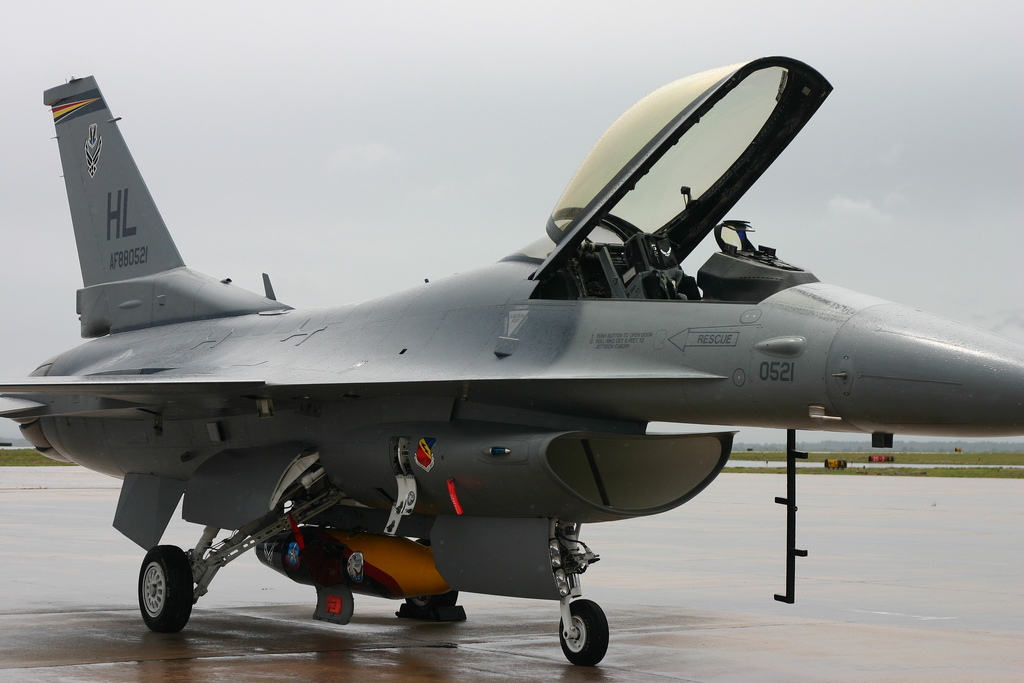

SMOKEY: I can't believe you didn't post a picture of an AL ANG Viper!!!

Revisiting an older thread, I'd thought of that F-16 type of canopy-opening plan for my RV-3B, but couldn't design one that would be light enough and still stiff and strong enough for the winds of midwest ramps. Sadly, I had to abandon the idea. Too bad, it wins for looks.
Another thing of interest is the relative size of the engine inlets between the RV-3B and the F-16. I think the area of the inlet is directly proportional to the fuel cost, hey?

If its any consolation, I enlisted Ken Krueger’s design brain when we were building Tsam to see if we could figure out an F-16 style...no structure there to support it. So we settled on the (sorta) F-104 option....

Maybe a fastback, or partial fastback, conversion would give you enough to work with to mount a rear hinge?
