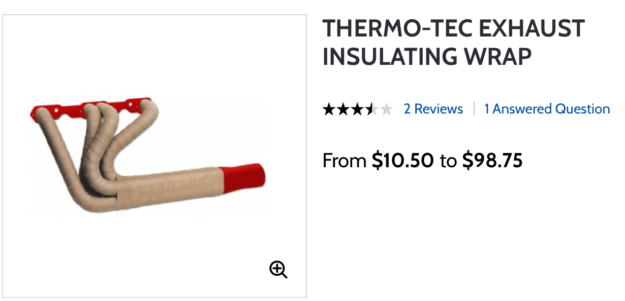

You could also wrap the pipe.
Check Aircraft Specialty or Summit Racing.

Jim,
Yes. I know they also make heat shields for the turbine housing too. It would be good to put some temp sensors in there to get some data to see what is really happening. But right now I just need to try to stay focused on getting it flying!
