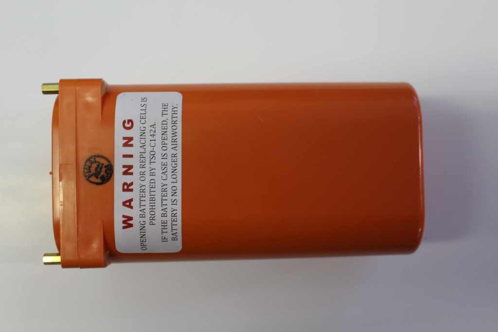

I just replaced mine. I considered replacing the batteries myself but after finding a new one for $125 shipped vs $75-80 for replacements I just ordered new.
What I wanted to add was the new one came with a sticker on it specifically warning against replacing the batteries and voiding the TSO if it the case is opened...they must have seen this thread!

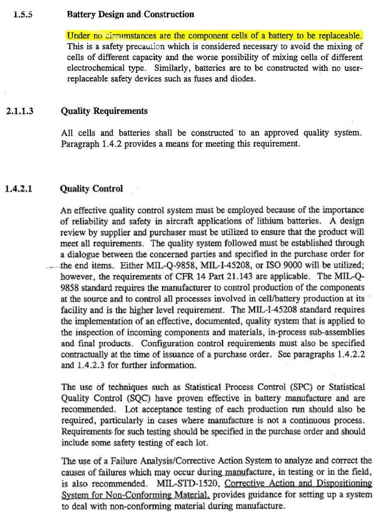

We have received a number of calls recently asking if it is legal to replace the cells in the ACK E-04 TSO-C142a battery pack. Several callers referred to this thread.
The short answer in no. Opening the battery case,and replacing cells is forbidden by the TSO. The person who posted the instructions as most builders, plots and even mechanics do not have an understanding of the TSO requirements. All modern TSO’s over the last 25 years are simply a general outline of the requirements to be followed in receiving TSO approval, and always refer to a specific document, or documents which the product must be tested to and conform to in order to receive the TSO. Almost all avionic or electronic related TSO’s refer to RTCA documents. In this case the document is RTCA DO-227 Minimum Operational Performance Standards for Lithium Batteries which is 91 pages of test and manufacturing requirements.
I have attached the relevant sections of the document that prohibit replacement of the cells in a battery pack by anyone other than the manufacturer. There are also requirements to have a QC procedure in place that must be followed as a manufacturer, and requires we have certification from the cell manufacturer of each shipment, and have a specific Quality Control systems in place. The photo that shows the expiration date, manufacture date and lot number as required by the FAA provides reference to the Quality Control process documents that were in place when manufactured. One of our competitors ignored these requirements and had all the TSO’s approvals they held revoked. The FAA requested we label the battery with a warning removing the seal on the screws and opening the battery pack renders it un-airworthy.
The FAA and Canadian authorities are extremely concerned about Lithium batteries in aircraft bordering on paranoia. There new testing standards forthcoming that further address requirements for the use of non-rechargeable Lithium batteries in aircraft.
