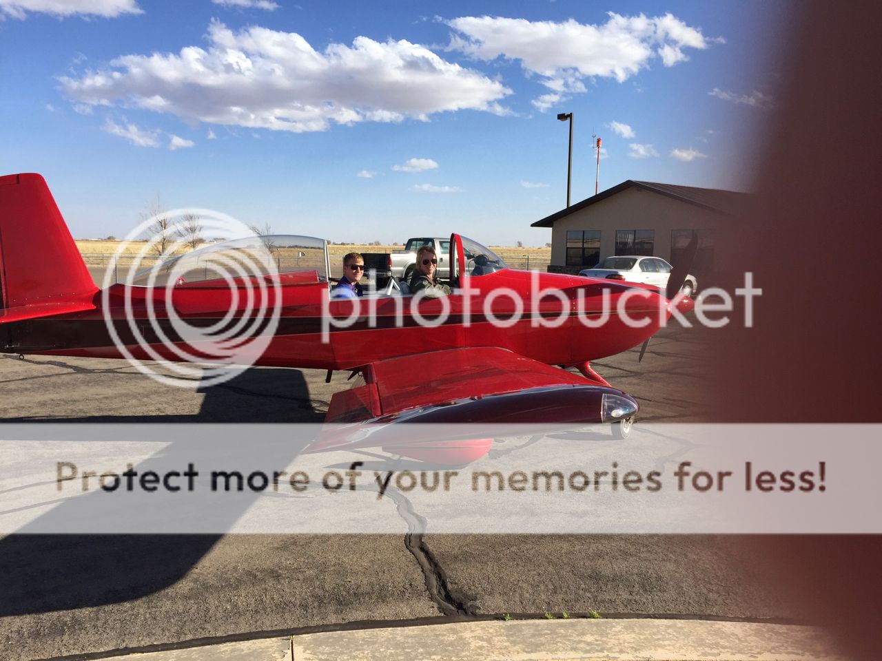

Let me tell you a little story about sex appeal. Once upon a time we diverted to an alternate somewhere in NM. Even there the surface winds were howling near RV stall speeds. There were two intersecting runways, my copilot and I were readying for a good beating. 10 miles out an RV8 calls, a calm female voice announcing she is planning 19, it was very relaxing to hear.
After landing she transmitted try rwy 26 she ran out of rudder on 19. So we did. Landed on rwy 26. Touched down three times then finally stopped. She was still taxiing to the pump where we had a brief chat. Active duty just bought her first airplane. I asked to take a picture for the Kremlin. That's what guys I call sex appeal not the training wheelie placement.
