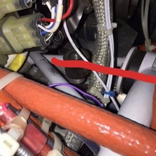

While replacing the broken bracket I lifted the coils beneath the ignition modules and found the powder coating worn completely through (located at the end of the red line).I primed and painted this small area then used a washer at each end of the coil attachment to shim vertically and prevent further abrasion.

Great idea, Tom! That's why I love this blog. You get the benefit of stuff found by hundreds of owners.
