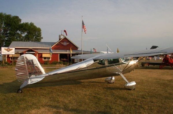

It's a sickness... Every time I polish I am look over at the spray gun and think I could just end this madness. I use the Nuvite process, best to keep up with it rather than having to do a full compounding and polishing. The cyclo polisher works well but gets heavy after a couple days but you can polish the polisher when you are done with the airplane!
Fortunately my RV is painted but here is my other airplane.
John von Linsowe
