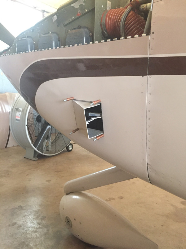

….We have had many customers mount our cowl flaps on the sides of the lower cowl as well as on the top. They report back many advantages, Lower ground operations temperature being one. Another is even lower climb out temperatures, due to the fact that the pressure in this configuration is much lower on top than on the bottom. We have seen most everything possible with flaps on top, sides, bottom and all of the above in one installation. The top mounted location is very popular in Brazil on the RV-10s. Its all good!

Please post pictures of those side and top mounted doors.

Originally Posted by VIN2020 View Post
Allan
...Here are some photos of one guys RV-10 installation and I will try to find others
when I get on my other computer. His are a bit further forward than most we have
seen, but will work very well in this local as well. Thanks, Allan.

Allan thanks for the pics of the 10install would like to put in a request for RV6 pics. as well 😀👍
