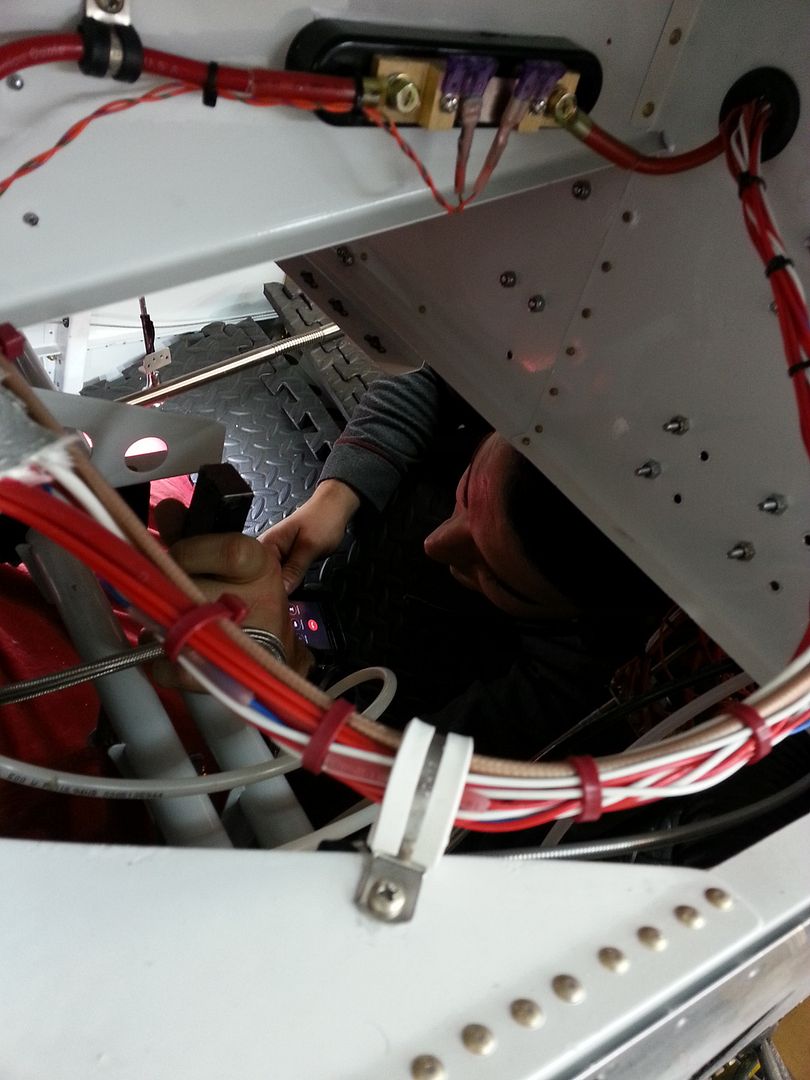

I don't get to see my kids that much since they are all grown, I made arrangements with my son and his busy schedule being a Paramedic and SWAT in Reno to come down and help me buck the top skin, did a great job! notice the Tungsten BB, best tool ever! skin on, windshield Sika on this week end!

That's awesome. Doesn't look like fun though.

The fun part is the rear side part of the top skin, couldent get a bucking bar there with the front roll bar bolts, after coming this far, there are 3 cherry pull rivets here on each side.....O well, won't see it with paint ;-)

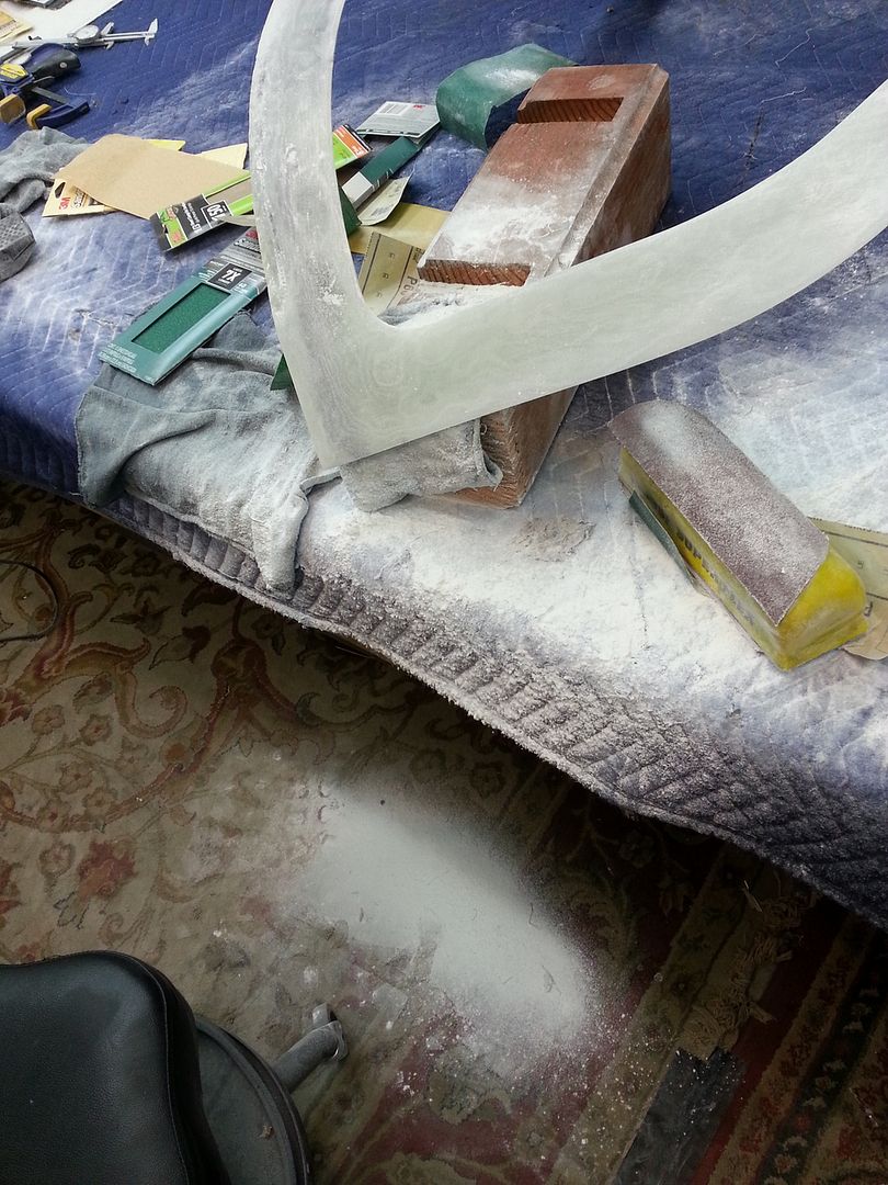

So glad I'm building an aluminum air O plane.....Ugg, canopy windshield skirt 5% done. I did a test of epoxy on acrylic and aluminum, and even after a prep with 60 grit and cleaning, I was able to pull the test fiberglass off Fairley easy. So I will sit in this chair for a month or so sanding on this skirt, then paint and finally Sika on to the plane.
