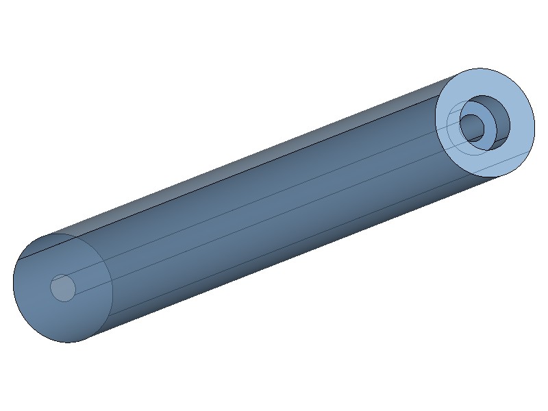

I had the occasion today to try to drill out a 470 and soon found keeping a drill (135 degree) centered to be nearly impossible. I made up a simple drill jig that centers the drill on the rounded head and sends the drill dead down the middle of the rivet. It can also act as a drill stop so you don't drill clear through. If you use it for a stop you will have to clear the chips from the guide tool several times.
Of course, a different drill jig will be needed for each rivet diameter. I did mine in a lathe because I have one, it can be done in a drill press by a very good eye for the center of the fixture. I do not recommend trying to make one with a hand drill and a vise.
I cannot be the first person to make one of these
Here is a commercially available tool. You can set the drill depth and chips clear automatically. I have used this to remove hundreds of 470's. Works on all sizes.
