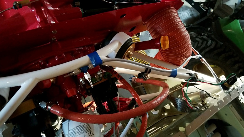

Bill and all. We utilize -3 diameter hose for our PMAG MFP lines. The lines have a clear plastic extruded coating for abrasion protection. The stem diameter of a -3 fitting is very small and helps to dampen everything out. We have specially made -4 Flare fittings that fit into -3 hose so that we don't have to change out the fitting at the MFP sensor and can still keep the -3 diameter hose on a -4 diameter fitting. The same is true at the engine. We include a 45 degree steel elbow for the engine as the routing is a bit cleaner that way. In addition, we include the two AN Tees and the -3 fittings at the second tee end for attachment to the rubber hoses for the PMAGs.
This first image shows the lines and the tee setup at the engine and the MFP sensor
This second image shows the unfinished system awaiting the rubber hoses to connect to the PMAGs.
