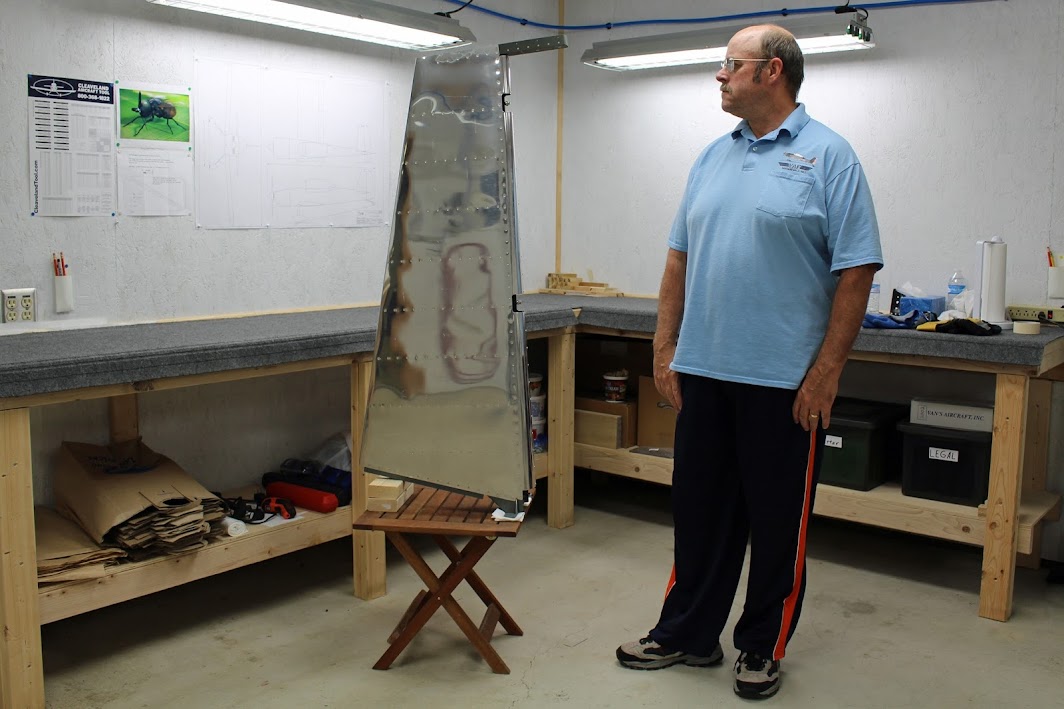

Getting closer to a completed empennage; working on finishing the elevators. With the stabilizers mounted on my empennage stand, I hung the rudder for the first time... just to see it.

... and yes, it does occur to me that I'll have to modify my empennage stand to make room for the elevator horns. Still need to trim the bottom of the HS rear spar, too... and the HS skins to make room for the elevator counterweights. Always more work...

You're shop area is too clean!!! There is no way you can work in there,
Nice job!!

So is the screaming dragon in the background the pattern for you paint job? Metal works looks very pristine, as does the workspace. Nice job!
