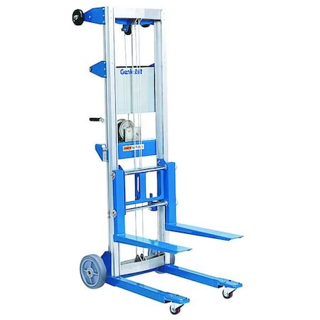

I built one of these, without plans, last month. I had seen pictures on VAF years ago, but when I searched for them they were all gone. It took me about three days in the shop and going to the airport to modify an redo to get it right. Iím pleased with how well it works. Larry (Larco) seems to have built his in less time than it takes me to get the welder ready. Excellent job Larry.:

I saw one of these Genie lifts on craigs list years ago for a few hundred dollars and grabbed it. Bolted a 3/4 plywood deck to the forks and cut a hole in it for the wheel to nest in. Works like a charm. Rated for 500 lbs and very stable. Also makes leveling a TD for weighing a simple task.

A fine lift, but can't be stiff enough to confidently allow crawling around back in the tail. Remember, there is a big difference between stiffness and strength.
Structurally, the upright members have no significant base width, so they can flex on the base structure. The base structure itself has the wheels out on the ends of horizontal members...wavy wands in the stiffness context. And lateral stiffness of the carriage depends on the bending stiffness of the long rails.
Remember, the original product was designed with shipping in mind. If you're going to build your own, a simple redesign could improve its utility. At a minimum, substitute 1" x 2" 16ga for the 1x1 base members and carriage rails. I'd use 3 x 1-1/2 if I could get it in a light gauge, with the forward wheels between tabs on the 1-1/2 centerline. The single 1x1 rear upright (the one with the winch) would become two 1x1 uprights, pyramid fashion, extending to a point near the rear wheels. They're only loaded in tension/compression, so they only need a wider base. Space the carriage rails farther apart, so the arm with the rollers can be a length of rectangular tube rather than the 1/4 x 1-1/4 bar.

I love my "tail-mate" but I don't rely on it for strength when crawling back into the tailcone. I lift the tail with the tail-mate and then place a sawhorse under the forward end of the tail spring.

I'm with Mel (and Dan, really....) - the TailMate is for lifting, a padded saw-horse is used if we're goign to get in the airplane. I don't crawl under a car that's just on a jack (without jack stands) either!
With an older (and aging...) spine, I won't let my TailMate go - too much twisting to lift RV tails by hand.
I'll have to take a picture of the MONSTER TailMate knock-off our former partner built for our Tundra. I could lift a small car with it......

I still have the original drawings I made when I designed the Tailmate.
My first opportunity to sell them was when I purchased a 10x10 space at SnF back in 2002. Sat there all week and didn't sell ONE unit! All I got was people taking pictures and saying they could build their own for less money. Then they were $179.00. All I said was...go right ahead...have at it. Let me know when you exceed $179 assuming you work for more than a dollar an hour. Everyone around where I live who had an experimental wanted one and was delighted to spend the money for one. My how times have changed. I am so enjoying this thread. For those who purchased one...Thanks for the support. For those that took pictures at SNF...How is the tailmate build coming along?
And lastly...NO! The TailMate WAS NOT designed to be stable and strong enough to crawl back in the the tail...Mel is right!
