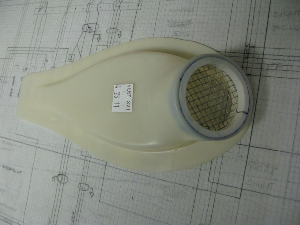

Find some PVC pipe a little larger OD than the ID of the NACA vent
Cut 2 rings for each vent and cut each lengthwise, to allow insertion and give some spring tension to hold in place
Sandwich your chosen screen between the rings
Add a couple of drops of thin CA
So far so good @ 300 hrs...

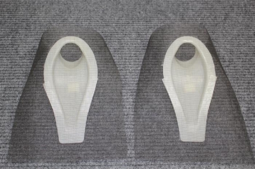

Some good ideas here. Actually, I was thinking of something like this... sealing the screen across the initial opening and sandwiching it between the sheet metal and the duct with RTV & blind rivets. Not sure if the screen layer would influence how much air would enter the duct. Permanence vs. repairable is also an issue. Some of the solutions here are repairable... but the opening is still an invitation to nesting critters. Will wait to hear more feedback before committing to this plan. The photo is for illustration only. Obviously I would trim and seal it before installing. Also going with synthetic mesh, rather than metal. Not as durable... but no corrosion issues.

Consider maintenance (replacement) down the road. Peeling the duct off to replace a broken screen (some kid will poke at it) won't be fun.
