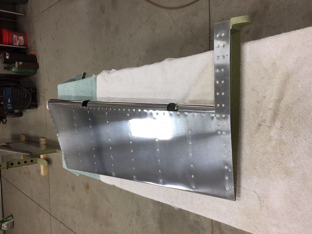

Its a good thing I took a look at this thread. I was not reading ahead and cut both weights the same as shown in the picture of the right elevator. I ended up milling them and it was easier to do them at once.
I have not finished the left elevator yet but the weight has already been match drilled. What is my best course of action at this point? Drilling another weight and getting the holes to match up will be pretty hard (lead is not fun to drill).

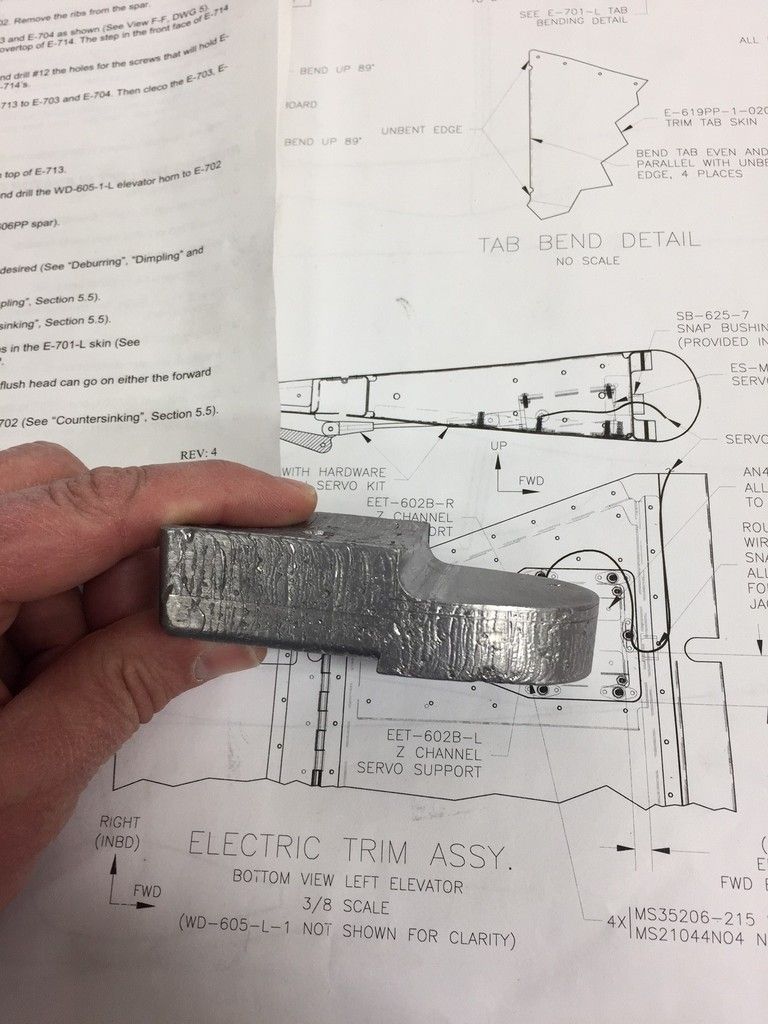

This is my weight for the left elevator. As you can see I cut it the same way the right side is. I have already match drilled it to the elevator, what would be the best way of fixing the mistake. I am assuming that it is going to be difficult to drill a new one and gets the holes to line up perfectly with the rib on the inside.
I was considering using some aluminum sheet metal to create a "mold" so I can heat that end up enough to melt it and add more lead to bring it back to its original shape.
Thanks for the suggestions in advance.
