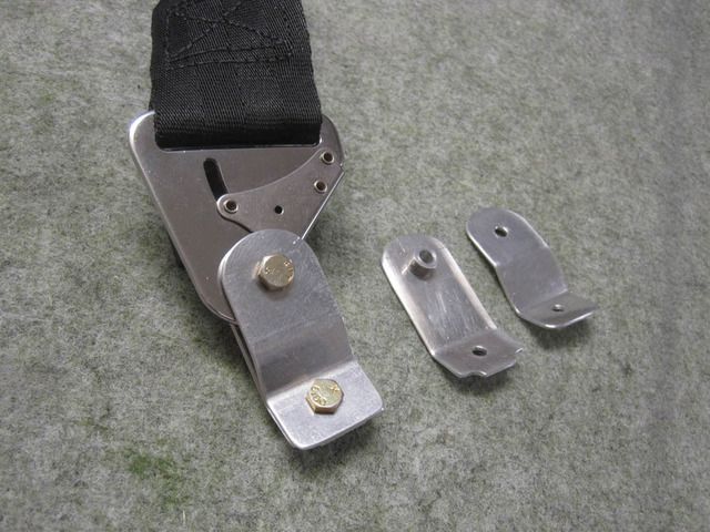

I was more concerned of opening/unlocking the main belt inadvertendly so I installed like a receptacle for a second lap belt. The belt is installed in only 10 seconds and removed as quickly. When not used as a lap belt it serves as a baggage holddown. The belt is from Aircraft-Spruce like 13-00301.
I used the same attachment point and used AN-3 bolts (loaded in single shear).
The other AN3 bolt is clamping an aluminum tube between the arms so that the belt hardware slides in easily.
