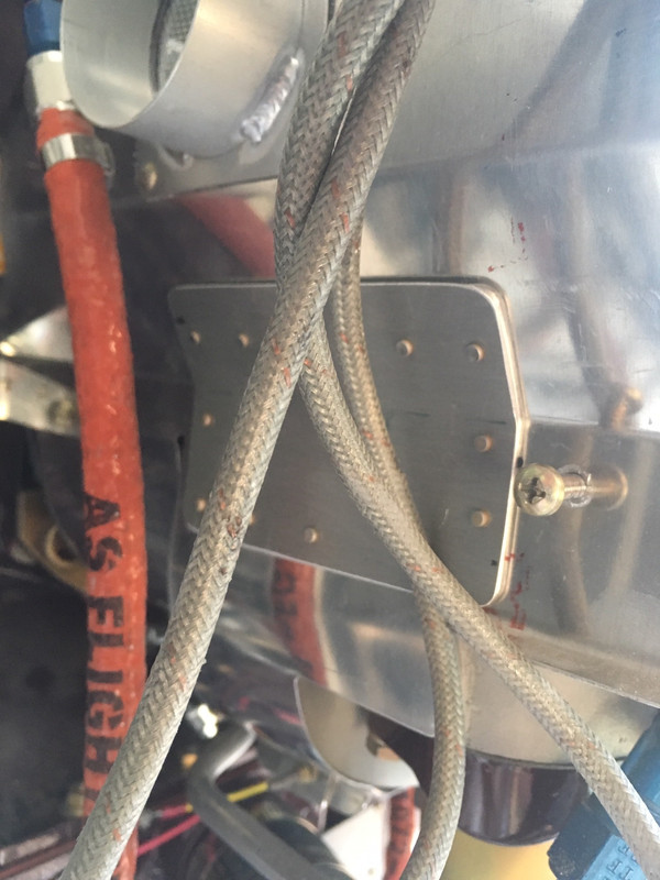

Here's a view from the front of the engine. I scabbed on extensions to the baffles on both sides of the engine here. The stock ones left very large openings between the crankcase and the baffles.pic free host
Here's my current solution to the #5 cylinder air bypass. It is just a hole cut in the baffle, a 1/2" wide doubler (of 0.63, I think) around the hole, with a plate riveted over the top. That gave me an air passage that's about 0.095" deep, which should pass more air than what I've got on the RV-6 and has worked well for 18 years. I did not make a bypass for #2.
