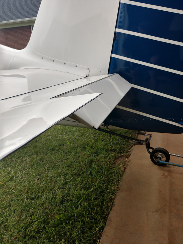

Multiple times I have recommend flying the entire pattern in an RV-9(A) at a constant speed; abeam the touchdown point, put in all the flaps and trim for 60 knots, if heavy. (55 knots, if light.)
Here is a picture of my trim tab after a recent flight. It gives a pretty good idea of how slow you can approach in a -9.
Note: this picture was taken after landing with full tanks, no baggage, and only my big 'ol butt in the aircraft.

What I see here is a nose heavy aircraft. This trim position has nothing to do with landing slow.
Nope, not nose heavy at all. In fact, due to the Catto prop, P-mags, lightweight starter, etc., the airplane is a little bit tail heavy, compared to the W&B's I've seen. Besides, with the RV's being nose heavy is a good thing as everything, including fuel burn, moves the CG aft.
