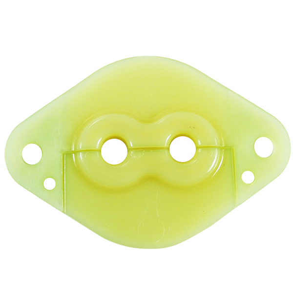

to look something like this

thinking of this design and how best to print..... kicking it around.

Make it in three pieces... Make the two halves for the cable holders, but put a flange around the outside that would sit on the baffle. Those pieces can be printed with the split plane (through the center holes) on the print bed. Make a third piece for the mounting flange, that fits around the cable holders, but has a recess to fit around the flange as well. Print that with the front (face we're looking at in your photo) on the bed. The recess won't need supports that way. It will also allow the cable holders to "float" a little bit, which may help with alignment/installation.

Three pieces is a thought but prefer to be minimum parts. I'll try this and see how it goes with carbon/nylon, two pieces. They are mirror pieces like the Slick but the pins are not mirrored. I'll print a couple of these to determine if it is possible and if so, then tweak it to close the gaps.
carbon/nylon
first print, some work to do but encouraging.
