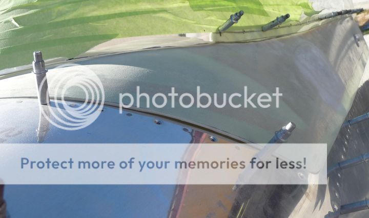

Dan and I overlapped the forward edge on top of the top skin instead of matching the height of the forward edge. It will act as a bit of a wind/rain scoop depending on fit.
Looks like this Paul...about an inch of glass, maybe a bit more, added to the front edge of the canopy frame to overlap the screw line. Brian intended it to be a flush fit, but there's no bulkhead under that screw line, just a double-flushed strip doubler. It's hard to convince the unsupported edge of the aluminum to conform to the exact profile of the pre-molded fiberglass. I debated reworking the glass to match the aluminum for the intended flush fit (which would not be hard to do). In the end I liked the appearance of hiding the screw line.
As the overlap was laid up with the canopy frame latched firmly to the fuselage, the original fit conformed to the aluminum perfectly. In the first year the right side developed a gap of about 0.050" along a stretch of 3" of so (arrows). I think it's from the weight of the canopy when sitting open in the sun. Note that the fit of a flush setup would have changed the same way. Anyway, there's an air leak there that gets directed across the face of the panel by the internal canopy rib. I've threatened to install a smaller version of a blow-up seal like Dave Buntin did on his slider, but it's so "not bad" that 3 years later there is still no motivation. Worst case, I pull on nomex gloves when OAT is below freezing. Compared to a slider, these tip-overs are hermetically sealed.
There's no right or wrong here; do what you like. Scott and I are tugging Brian's appendage just a bit

Thanks Dan, that explains it perfectly.
I won't mind having those screws visible. It'll at least give the appearance of some structure beneath.
There is a bit of flex at the doubler. I'll see how things looks when I get there.
And anyhow, an extra (non planned) shot of cool air would generally be a blessing where I am.
I remembered seeing a pic (below) showing the area you pointed to, (albeit on the other side), illustrating the potential challenge of getting things to fit.
I think it was Bud Silvers'.
