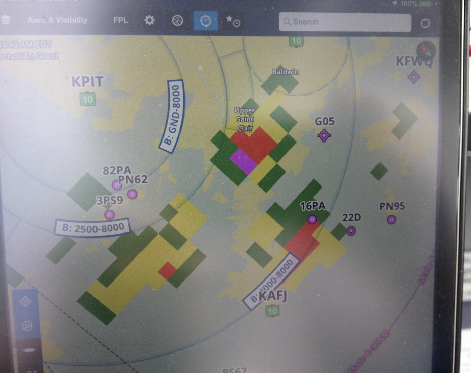

I have an echoUAT displaying traffic and weather on a mini iPad3 running ForeFlight. The weather is depicted in very large block pixels. A friend has dual Dynon HDX and his in-flight weather is smooth contours with no pixilation.
I contacted ForeFlight and they tell me that weather from the ADS-B is normally the large pixelated version of radar. The nice high definition radar takes a lot of data to render and the ADS-B system needs efficiency.
See cell phone photo below of my in-flight weather. Is this what everyone’s ADS-B weather looks like?

The closer that you are to the radar image, the greater definition you should get. In other words, what you showed us here is what I'd expect to see when you're several hundred miles from the location displayed.
How far were you from Pittsburgh when this picture was taken?

The radar data is binary: if looking within 250 nm of your position, you should get higher definition. If more than 250 nm, you get the larger pixels.

I flew just a couple days ago and was ranging from 5-30 miles from some heavy rain in my area. The entire flight the ifly 740 display fed from uavionix echo UAT looked exactly like yours.
EXACTLY. Most people on this forum don't understand the RADAR data being transmitted to them and how it is displayed.

All EFIS systems receive the same NEXRAD data streams. Some vendors believe that it should be displayed as is. In this case you will see a pixelated edge. Other vendors will use algorithms to operate on the data stream to smooth the contours.

About 90 miles away. This image is typically what I see even when receiving multiple ADS-B towers and weather is close.
My guess is ForeFlight chooses to display pixilated radar and Dynon, with their fancy HDX, chooses to smooth and contour the edges - each using same data stream from the ground ADS-B towers.
I wonder if ForeFlight couldn’t massage the data internally in the EFIS (in my case mini iPad3) and display a smoother image? I understand bandwidth and efficiency of ADS-B being sent up from the towers, but once the data is received maybe ForeFlight can pretty it up? Maybe some EFIS don’t have internal capability to manipulate data but an iPad is ideal for doing that. Perhaps FF, if running on an iPad, could do special radar rendering? User might need to stipulate what type of EFIS is being used just like user now chooses 4-color radar, etc.

I think the pixelation is a good reminder of how inaccurate the picture can be. Artificially smoothing it out could give a false sense of detail and encourage somebody to shoot a gap that doesn’t exist.
Another question is, are you sure your buddy’s data is from adsb and not XM? My GRT displays radar the same as FF, for the record.

Good point on the pixelation. Probably some liability concerns on FF's part.
My friend doesn't have XM so the radar image depicted on the HDX is from ground ADS-B. I'll snap photo next time we fly...
