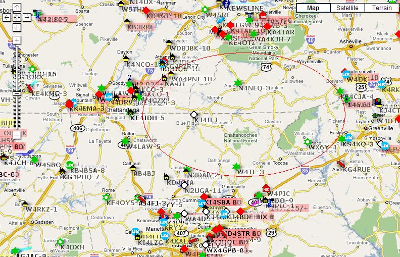

Hey Kahuna,
I finally got my iGate up and running today. I'm just North of you near where GA meets TN and NC (KJ4ILJ). There is a HUGE service gap in the North Ga mountains and now, hopefully I can help fill the gap.

Bret,
Your iGate should be a great addition to the APRS net. You are in an excellent location for an iGate and will add valuable coverage for those flying over some tough terrain.
Glad you stuck out the sometimes maddening process of getting the software configured. Some of it definitely is not user friendly.
